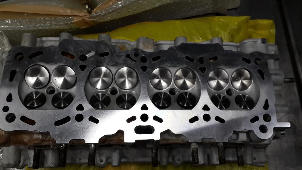

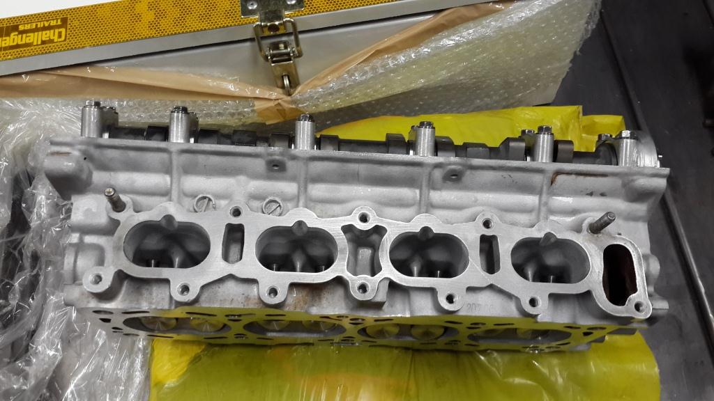

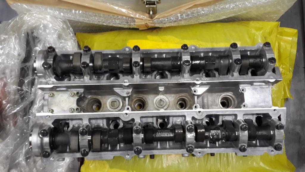

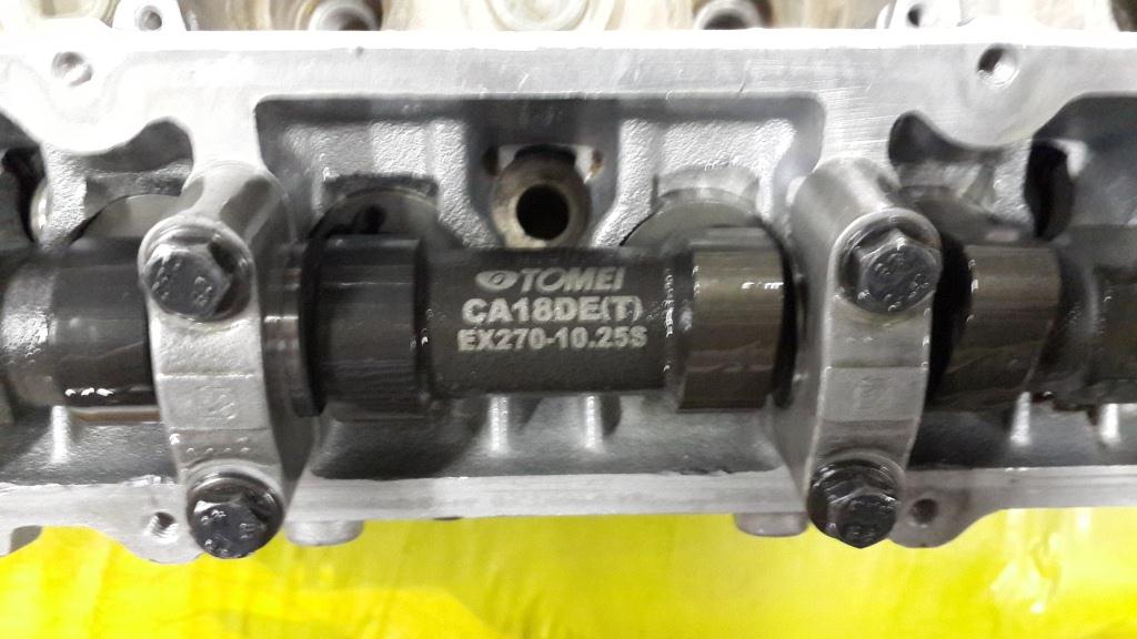

Update time!
Head is fitted with the Tomei 270 deg 10.25mm cams in the 4 port head, we needed to grind the head for the cams to fit. Redone the head and found some issues with it.
Now im just waiting to finish the bottem end and then we will assemble!![200SX_2guns [smilie=200sx_2guns.gif]](./images/smilies/200SX_2guns.gif)

Re: My 200sx and the issues (Pics ADSL)
What did you need to grind on the head? Still using hydraulic lifters?
Hi Gary, The lobes doesnt clear the stock head so you will need to grind away on the head as per the last pictures to make space for the lobes to run in the head. Im running the tomei solid lifters now.

Man looking awsome, Crazy how you had to grind the head to allow the cams to turn freely. Does the tomei product guide or spec mention having to do that? How do those solid lifters work are they shimmed Do you have to adjust valve clearance with them in some way?
Hey Gary, Gt3076 comp wheel is too small... my turbo is quite a bit bigger and can supply more than 500hp, think mine is rated to 650hp. My turbo is basically already a Garrett with the billit comp wheel and housings. Just my bearing housing is journal and my ex wheel.
The valve lifts basically look like the stock lifters but instead of a hydraulic inside it has like a valve stem on the inside and the shims fits over the valve stem. The shims needs to be measured individually and fitted to get everything nice and sorted so that each has the correct clearance.

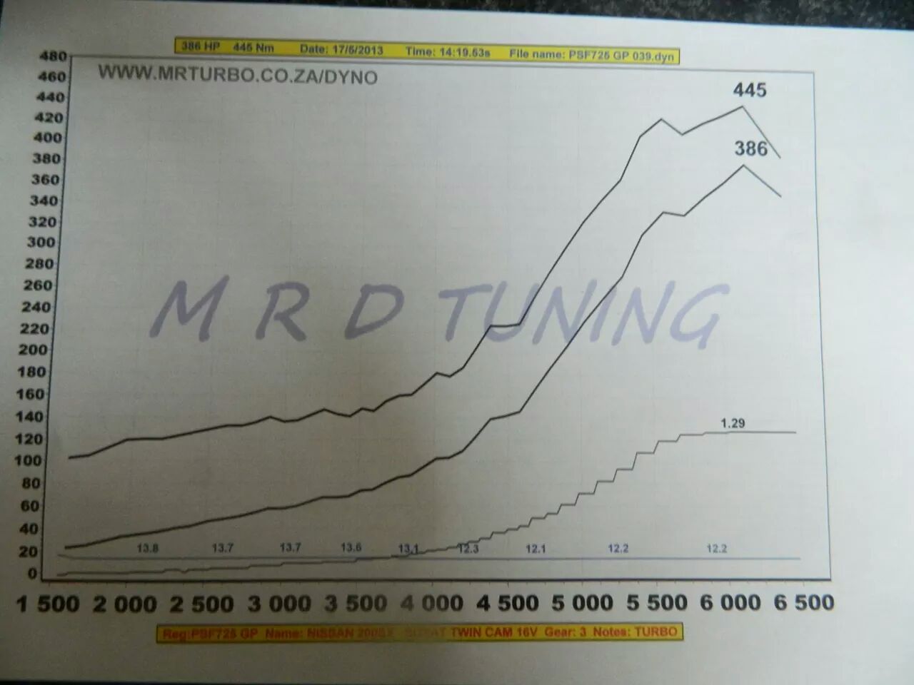

- Attachments
- Here is the prev dyno sheet with all the issues...im really expecting allot more this time around. You can see we only took it to 6200rpm...we should take it to 8500rpm...will see what the dyno says this time around.
- IMG_239488314284827.jpeg (84.48 KiB) Viewed 82577 times
What boost are you aiming to run?
Well have to see, but i estimate with the cams we would be able to see 440whp on 1.2 bar boost at 8000rpm... I recon we will need closer to 1.6 bar. If the motor is running 100% and it has a few miles on then i will maybe push it to 2 bar for a couple of runs to see what she can do.
