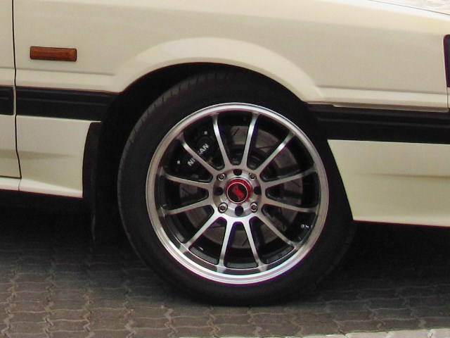

Brake change done, some updated photos:
Re: Project R31 Skyline
this car is awesome!
Loving the look you going for... Just needs more LOW...

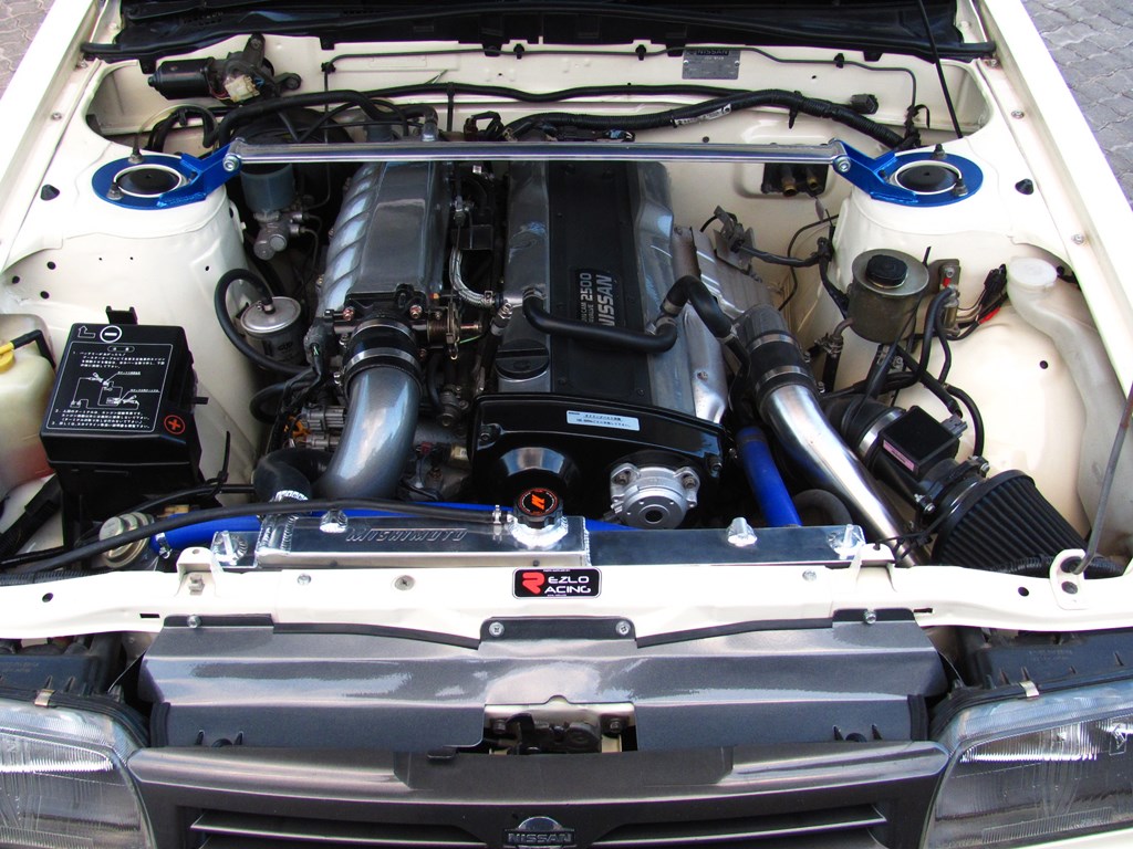

Was the intake cut and re-welded to move the throttle body? Looks super neat really nicely done!
Skylinefreak
Posts: 520
Post by Skylinefreak »
troopiec wrote:Was the intake cut and re-welded to move the throttle body? Looks super neat really nicely done!
Yup, and then lots and lots of grinding and sanding to get it smooth before powder coating :D
