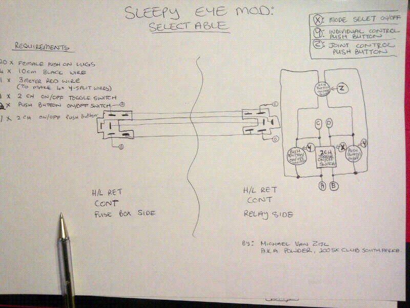

Ok so I have made some progress, here is a diagram I drew up for project lazy eye. . .
works with lights on or off, allows individual or joint adjustment and requires no cutting of the stock harness. . . Hope it is easy enough to read. . .
Will upload pics of it done when i do it, have to first Finnish what i currently busy with, priorities. . .
Enjoy boyz
Enjoy boyz
