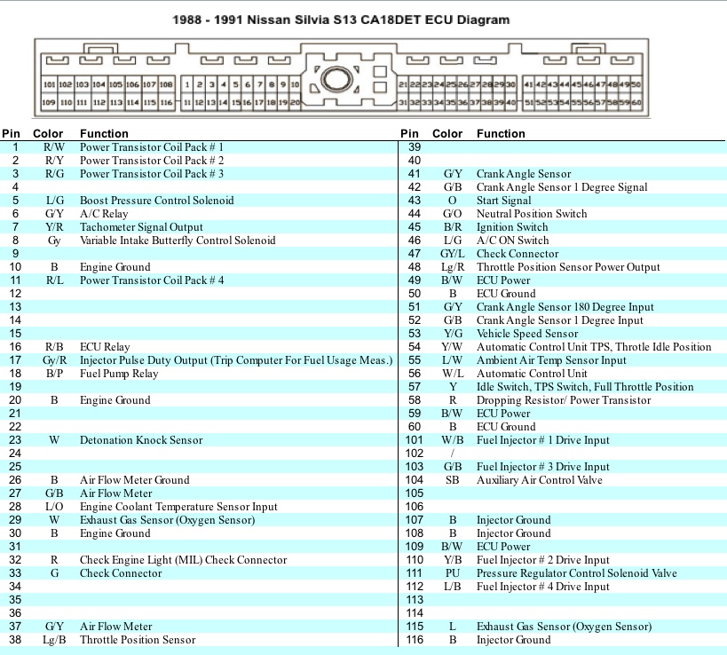

ok you can see there 2 wires that need to go from the cas to the ecu 1 degree and 180 degree. i stand to becorrected but 1 degree must be TDC

just make sure that 1 degree is TDC im not 100% sure

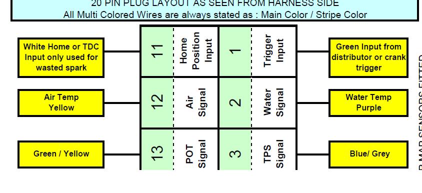

if you search you will see that i did a ful diagram to the tator ecu pin out

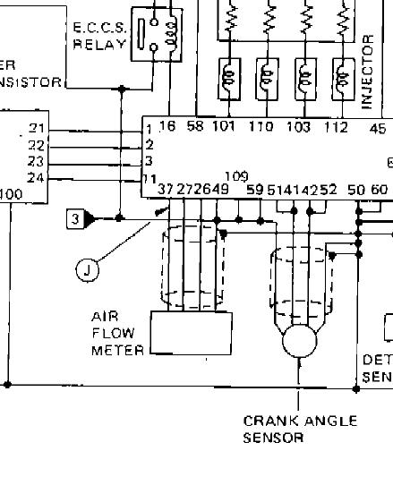

poizen why is intector 2 going to injector 1 and 4 should number to not go to 2 and 3?

I just ladled its brown 1 and 2
Reff this drawing to the tator one
Being wasted spark it doesn't matter to much but that's the way my tuner told me and my car ran fine
