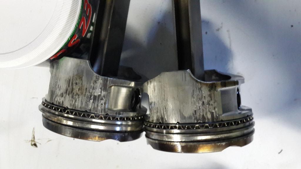

So i pulled the motor to see what exactly is the fault, and i found the following on piston 1 and 3....Whats your ideas?
The motor had a slight smoke to it and breathed after it came back from the dyno at a famous jhb guy...so im wondering....if its fixed up i am sure it will make more Hp than it currently made with this slight smoking problem it picked up in jhb (386whp)
Who has a block they would like to sell?.....i will measure but i think the sleeves will need a re-bore and i am already at 83.5 so fitting 84mm is not a option because that would mean that i need to get a new cometic head gasket and import pistons which would be costly as well....i guess if i cant get a block then i wont have another option but to import 84mm pistons and head gasket.

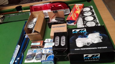

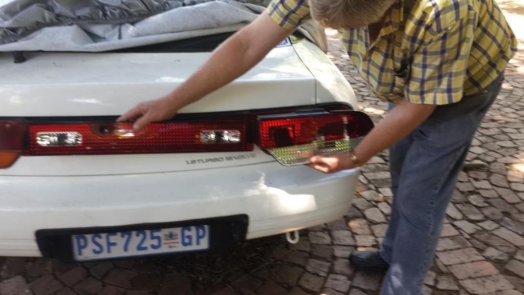

Hey guys, so here is my update with new parts.
I fitted the clear lights all round and everything is looking good. Will post pictures later
Got the new engine internals and have dropped the block off at the engineers for boring.

Post by Grobblere »
Pics of the lights fitted
