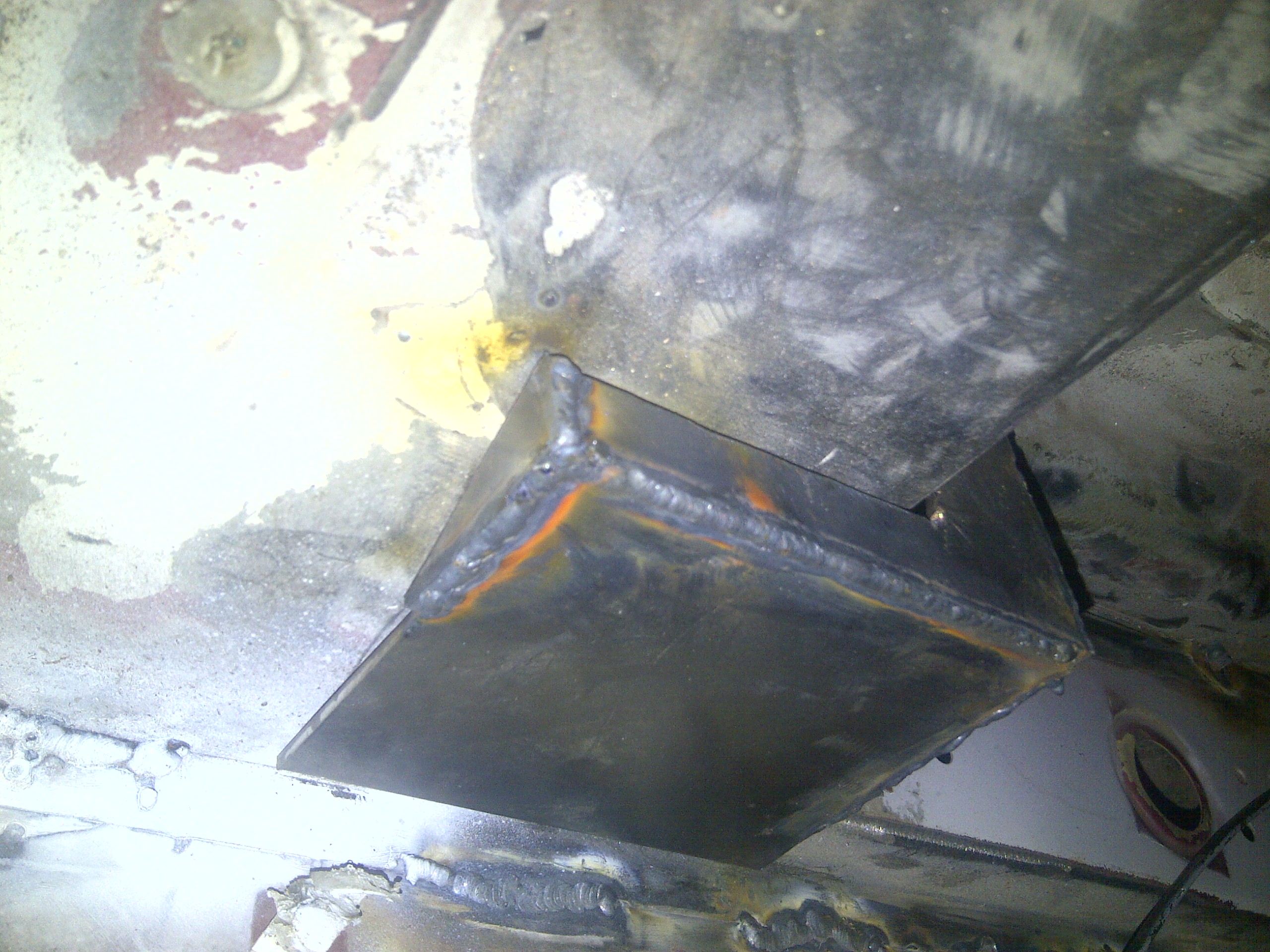

So my updates are
boxed the lower control arms up.
fitted the new head lights. changed my old hand brake for the one jason had but i used my lever and will use my master on it
Needed to make a bush for my lever to the shaft on the hand brake
