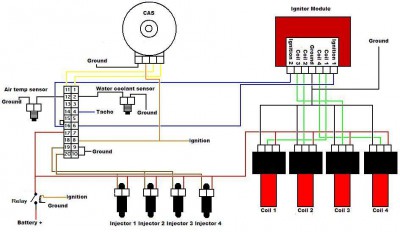

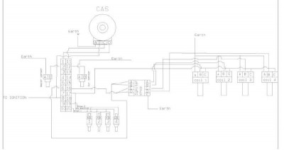

Thanks to Poizen for the diagram. [smilie=200sx_200sx.gif]

Post by poizen »
works the same for sr20 only diff is the Cas wiring you just need to swap the wires around iirc but the rest is the same :domo:

Ok refurb of the drawing :mrgreen:

Nice redraw but coils and injectors must not go to batt or they will be on all the time
injectors amd coils need to be connected to batt via a relay to ignition
Re: Wiring a Dicktator Wasted Spark up to a CA18DET For Dumm
Corrected...hows that?

Looks good im on my phone will look properly when I get on laptop
kwl thanks let me know what changes need to be made [smilie=200sx_200sx.gif]

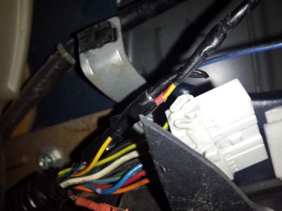

what features do you lose ? SonOfAnarchy ZA thanks for the reply, on the tacho cable on the dicktator where would I connect it up to ? coz surely if I remove my std ecu it will stop the rev counter working?

As for the rev counter, I believe you just connect the output from the ECU to a pin on the back of the cluster.
there is a plug there by the ecu that goes to the dash cluster will upload a pic later for you.
thats the plug you use and those 2 wire are the ones you need. one is for the tacho the other is your temp guage can remember which one is for what you will just have to measure which one went to the temp sensor
